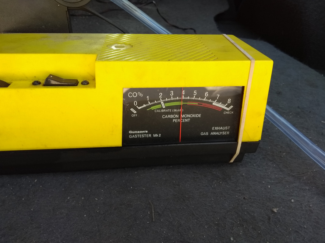

Just to get a "base" figure, i went out the other day armed with my trusty Gunsons Gasteseter and took a reading at idle - i was expecting (hoping for!) 1%CO at idle as that's what i'd previously set it at last year just before the MoT.
It showed 0.9%CO which could well be down to the nice new, clean, air filter! Then, for no apparent reason, it shot up to 2.6% and started running like a hatful of monkeys a***holes :
In other words, how it's sometimes been running lately and stenching of petrol at the same time - if i've left the car alone for a while, it's been a pig to start (hot or cold) after that, especially if it stinks of fuel when i get in.

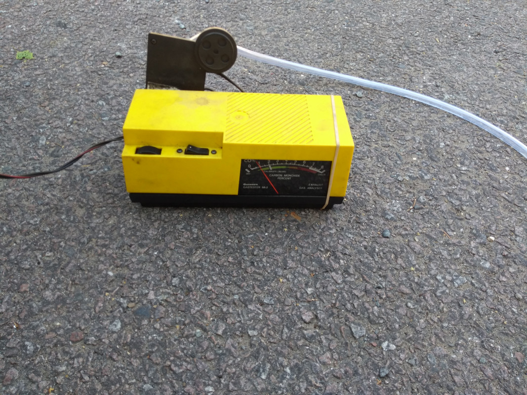

As i hadn't checked the CO after fitting the new injectors, today gave me a good time to check it. Took the car for a spin with the Gastester in the back, warming up on my jump-pack.
Calibrated it before starting :
Then shoved the probe up one of the tailpipes :
Then the electric cooling fan kicked in :

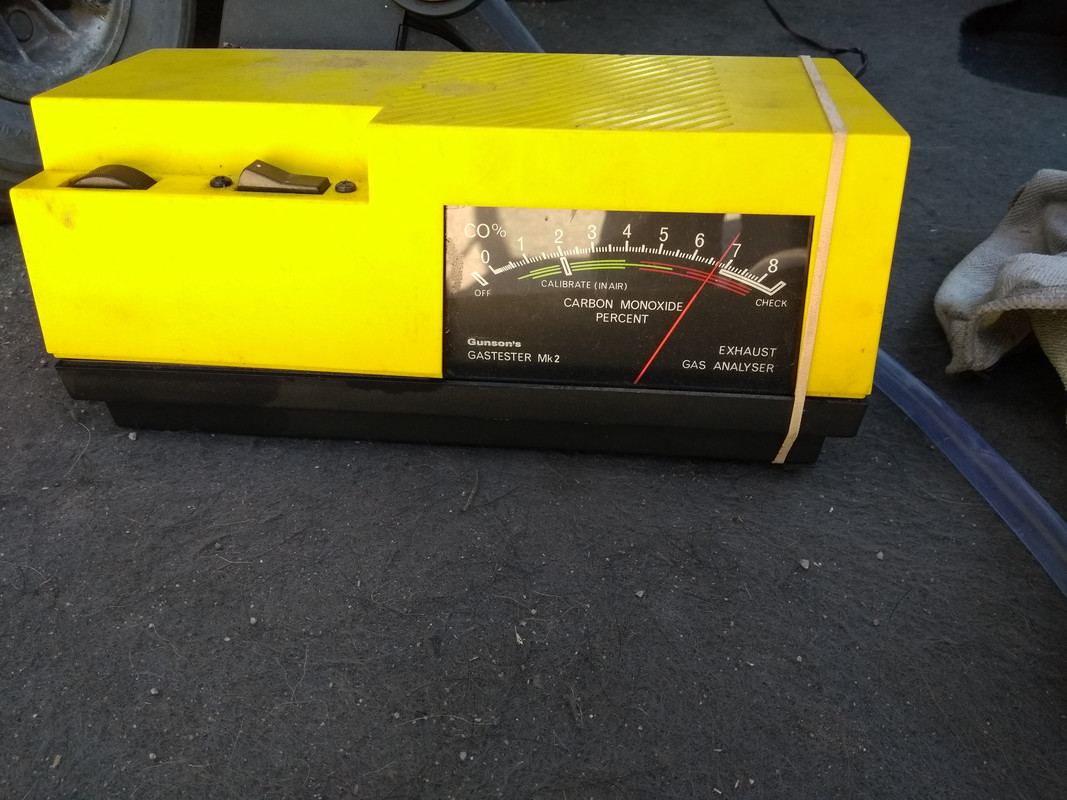

Next, i tried something else :
That's a tad high at 6.7%! :err: Only to be expected as i'd pulled the vac hose off the FPR and plugged it - first so i could check the FPR would richen the mixture when vacuum was removed, second so i could check for any fuel leaking from the FPR and third to eliminate the FPR from the process of working out why the CO level was now much higher.

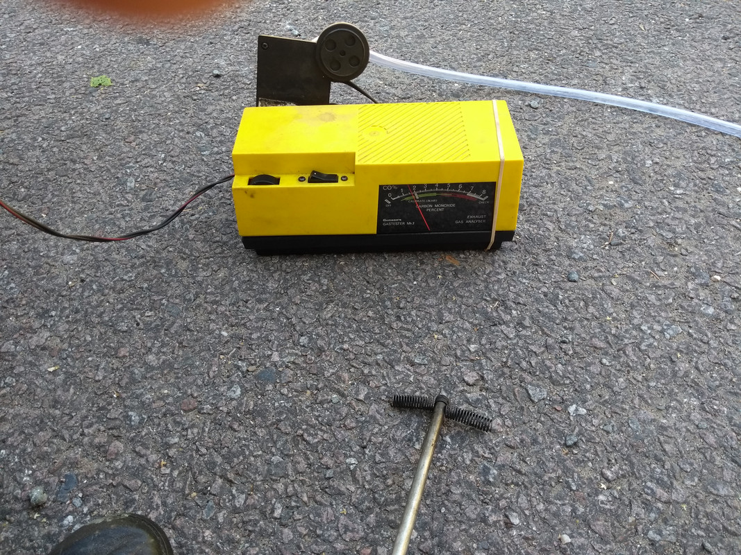

Refitting the vacuum hose, i turned my attention to the thermostatically controlled flap valve on the air cleaner. Given it was a warm day today, i would have expected the flap valve to mainly pull air from the colder side, not from the hot side where air is passed over the exhaust manifold first.
Wasn't happening that way, i removed the hot air trunking from the air filter end and noted the CO dropped by at least 1% - difficult to say exactly how much over that as the cooling fan kicked in again.
Then i looked at the mixture screw on the MAF. In the past, someone had drilled two holes in the plug on it and when i checked the CO for the MoT last year, it didn't need adjustment. Normally they won't need adjustment unless something is out of kilter somewhere so this got me thinking.
As the CO level drops and the engine runs extremely lean, this can push the HC content up a lot. My guess is that over successive years with the old injectors getting a bit worse each year that the HC level went up due to some cylinders (those with the duff injectors) weren't firing properly so each year, the mixture was tweaked richer until the duff cylinders were running right.
Now all the injectors are squirting better, this is no longer a problem and the CO ends up higher than it should be.
After turning the screw on the MAF 7 1/2 turns anti-clockwise, i finally got there :

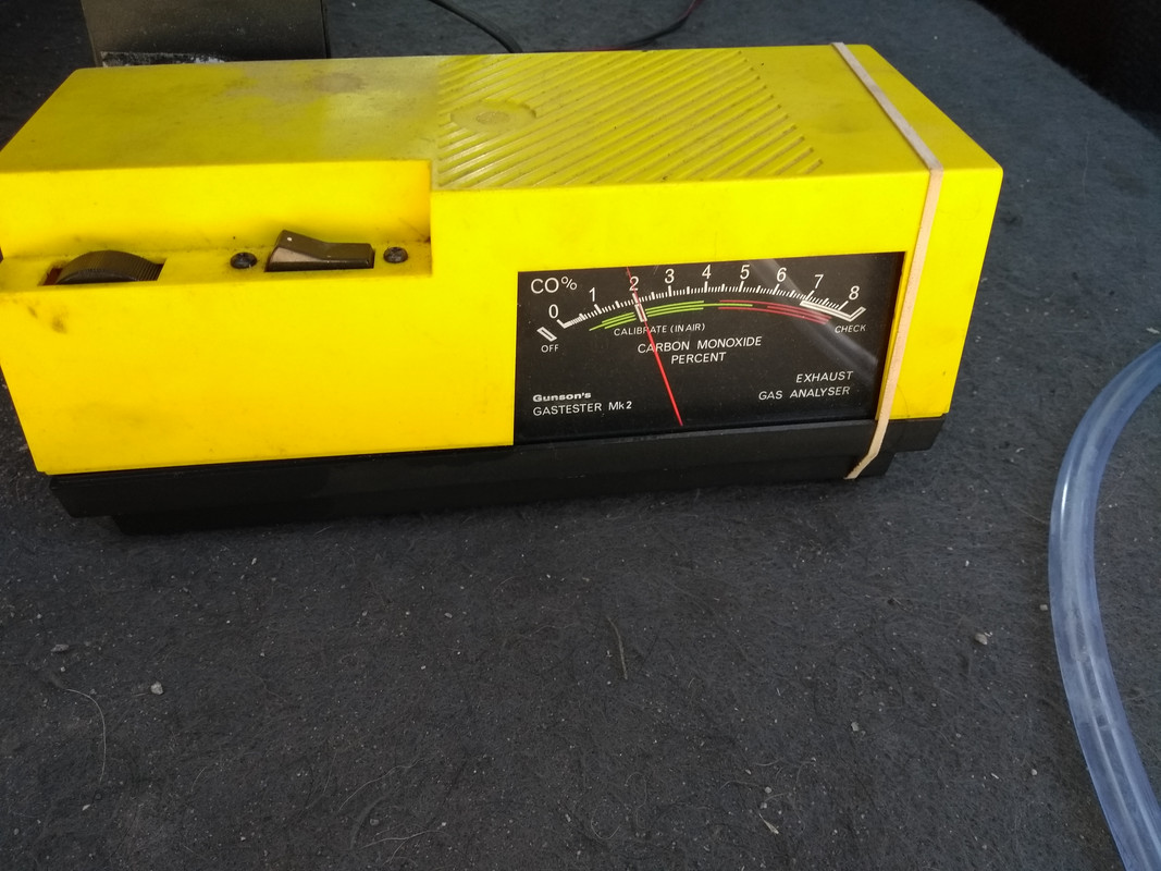

As a final check that the calibration hadn't wandered or been knocked by me :
Yes, i know - it's only at 1.8% in that pic and should be 2% for the air calibration point but first it had swung there pretty quickly and experience with this Gastester tells me it does that then the last little bit can take a few minutes and secondly, by the time i'd shut the bonnet etc and come back, it was up to bang on 2% so i know i finally reached 1% approximately.

- Posts: 10074
Re: Scoobys Dogmobile - Take 2!
There's also the question of where you draw the line to define "spending money" on a particular car as opposed to necessary expenditure that would happen with any car.
To my mind, normal service costs (plugs, filters, fluids, brake pads/shoes, tyres, wiper blades etc) are necessary expenditure so would happen with any other car.
Then you have the "not quite routine service but still wear out/fail eventually" sort of parts. Things in this category are things like track rod ends, Lambda sensors, ball joints, timing belts, shock absorbers, springs, brake discs etc.
I replaced the ball joints on the front because there was a nasty clonking that appeared to be coming from them, although it was difficult to be sure it was them as there didn't appear to be any play in them. They had to come off to replace the shocks and springs that were heavily worn so no extra work involved, just the cost of the ball joints which wasn't a lot. Cured the clonking though!
Last, you have the parts that tend to wear heavily in some ways to protect a more expensive component - almost on a "sacrificial" basis. On the 800s, it's the front anti roll bar drop links. On the Volvo it's the "spaceship bushes", better known as lower control arm to tie bar bushes. There are 2 per side and compared to all the other bushes (except maybe the drop links, they wear heavily on the Volvo too!) are almost suicidal in their wear rates.
https://www.ebay.co.uk/itm/BORG-AND-BEC ... 3415181094
I picked up a complete set of 4 with the spacer tube etc NOS on fleabay for about £7 i think it was. You can see why they're nicknamed "spaceship bushes"!
So far, all of that comes under running costs. Those things and similar depending on whatever car it is, are all bits and pieces that wear out and need renewing.
Out of everything i've renewed so far, the first item that hasn't come into any of those categories are the injectors. However they do wear, they get dirty, return springs inside get weak and so on, it's just not such a common thing to have to replace them. Go back 30 years to when the car was first made and many cars on the road at that time of a certain age were having new carbs fitted because they were worn. Those cars were probably less than 15 years old in most cases - we've all been there, ascending a pile of cars in the breakers yard to get the last remaining SU carb for a Mini/Marina or twin choke Weber for a Cortina/Capri or similar.
Scrapyards have changed, they now remove the bits, clean them (if you're lucky), put them in a box or Jiffy bag and post them out to you.
Instead of that 32/36 DGAV from a low mileage Cortina that you fought a war of attrition to retrieve from the automotive equivalent of Mount Everest, a neatly packed box of 6 injectors in Bubblewrap inside a sturdy cardboard box gets delivered by the postie.
The big question is, do the injectors come into normal running costs? If so, then so far, other than normal running costs, the Volvo has cost me nothing.
If you count them as an unusual expense then it's £45 and now i've sorted the mixture, they should pay for themselves.
The only thing so far i've bought that wasn't strictly necessary is the aftermarket cruise control. That's more for me than the car and arguably could be transferred to a different car in the future.
